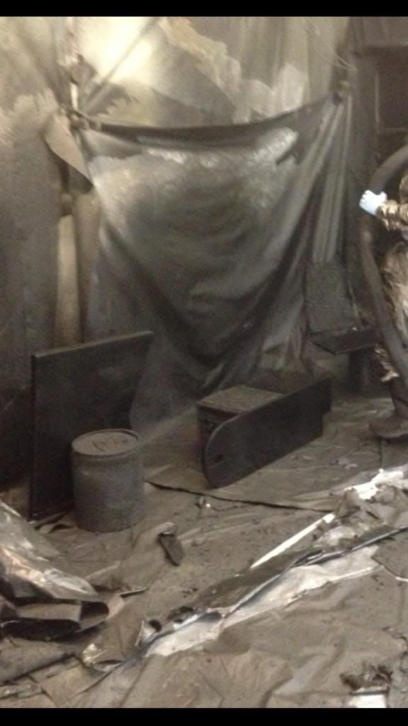

Here is a pic of the floor at the Factory, They will send you some photos to give you a heads up of what it looks like so you can spot problems before it ships
